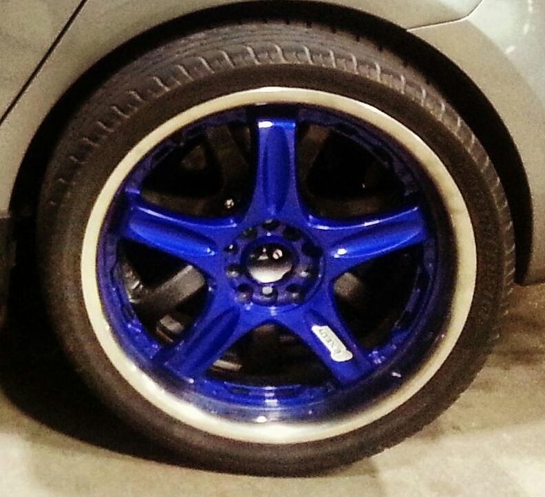

    Well I finally got a set of wheels, they are a little big but my friend isn't using them anymore so I cant argue with that price lol. They are 19x8 +35 offset so I think they will work. I have to do my 5 lug conversion before I can put them on though. So I will be buying a set of 5 lug hubs and drilling my rotors for the other bolt pattern soon. Maybe I could trade these for something better suited to my car but for now I will be running them.
