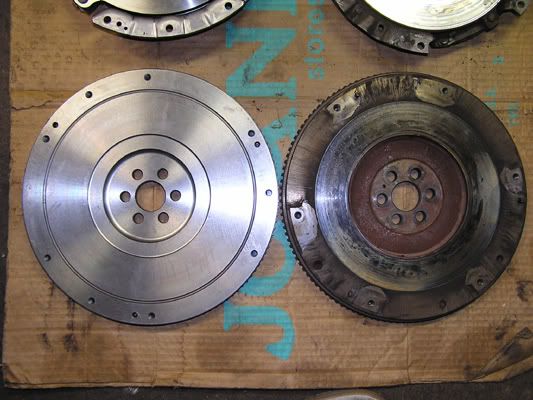

    this is both setups(225mm and 240mm) set beside each other
    here are the 240 flywheels, notice the O.D. is the exact same, but the surface area and bolt holes are different
    the pressure plates... mmmm that just looks good

    And there you have it, the "White Bunny Special". I'll update this if any new information comes up, and of course details after tyler breaks this setup in and gets to go alittle hard on it. Hope this helps!
